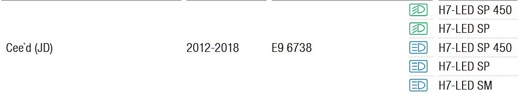

Dakle gledam za moj auto, pošto su Philips Vision Plus izdržale celih godinu i 7 meseci. Odnosno jedna, ova druga još radi. Pa se razmatra i LED.

Osram ima street legal modele u više verzija.

Postovi: 21006
Re: Auto sijalice
trojanac napisao: 11 Nov 2025, 18:13 Osram ima street legal modele u više verzija.
1) Approved LED light source – only applies to the respective countries in which there is approval or to which an equivalent approval applies, and the vehicle models and light functions currently listed in the compatibility list. For more details see www.osram.com/nb-led
Ako nađeš Srbiju bićeš street legal.
