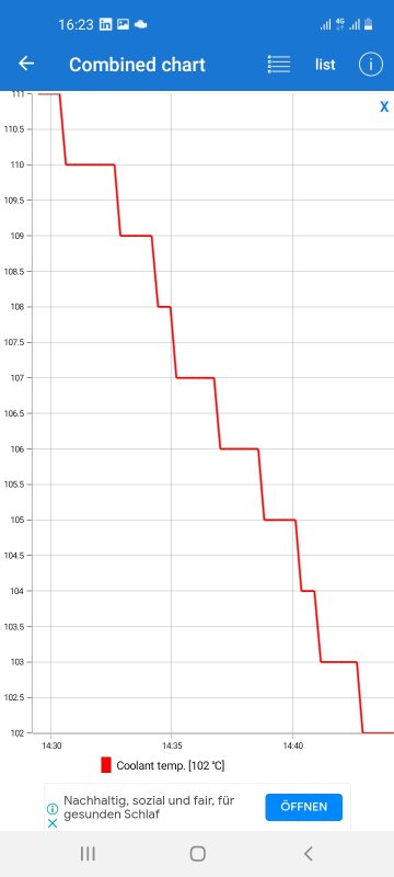

SrdjanN
Postovi: 134
Pridružio se: 27 Feb 2021, 23:33
Re: Rover 75 1.8 - pregrevanje
Post od SrdjanN »
OMP napisao: 04 Avg 2022, 12:15
I drove out about eight miles during which the traffic limited me to around 50mph. Cruising at 50mph gave a temperature of around 95-96C depending on throttle. Interestingly, you can see the effect of acceleration/decelleration very easily, the temperature rising then easing back once cruising speed was reached. At slower speeds the temperature was significantly higher. At 30mph it averaged nearer 100C and around 98C at 40mph. On returning, I managed a short run at 70mph, which dropped the temperature towards 90C and sometimes lower depending on my right foot. This effect was no doubt due to the low ambient temperature and air speed through the radiator. I wasn't aware that the cooling fan had come on at any stage, so I thought I'd check that when I got back home.
I parked up and left the engine ticking over. The temperature was clearly falling initially, but on standing it didn't rise above 100C or so. I guessed it would eventually get hotter but to speed things up, I held the throttle at 2000 rpm and watched the readout. Anyway, at about 107C, the fan switched on at high speed, so I dropped the revs and let it tick over. The fan switched off at about 97C. Happy with my test I switched the engine off.
kad se podigne temp. otvori haubu i gledaj dal radi ventilator ako ga ne cujes, ako radi pusti ga odradi i prati na koliko padne temp. kad se ugasi ventilator, kao sto rekoh trebalo bi da pali na 107 drugu brzinu a pise da se gasi kad temp. padne na 97
Juce sam testirao do 111 stepeni i nije palio ventilator uopste i onda sam ugasio auto i upalio se kratko ventilator.
Klima ne radi, grejanje radi. Kad se klima upali ne cuje se ventilator.
Sada sam vozio 30km auto pola grad, pola magistrala, i gledao sam u realnom vremenu kako se menja temperatura, pa je isla do 93 pa je pala na 87 i onda je opet isla do 98 i verovatno bi nastavila, bice da je tu u nekom periodu i radio ventilator pa je obarao temperaturu ili je to zbog voznje u nizim obrtajima.
A kad mi se desilo pucanje creva npr tada se nije cuo ventilator i posle nekog vremena se cuo i duze vremena je radio brzo i ohladio sve.
Poslednja izmena od SrdjanN u 04 Avg 2022, 14:11, izmenjeno 2 puta ukupno.

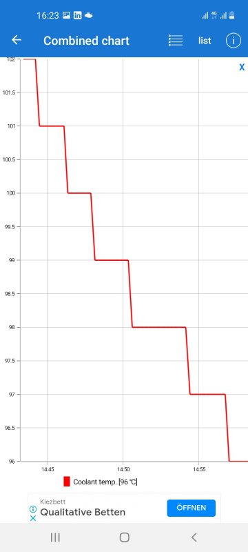

SrdjanN
Postovi: 134
Post od SrdjanN »
Cekao do 112 i upalio se ventilator i oborio na 90:
Je l to normalno?
Bice da mu je 110-112 kada ventilator pali? Ili mozda ne radi prva brzina pa se samo ovaj brzi upali?
