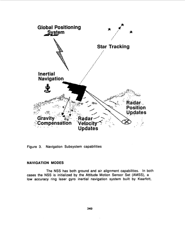

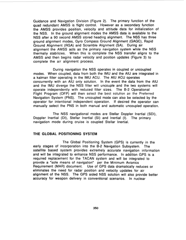

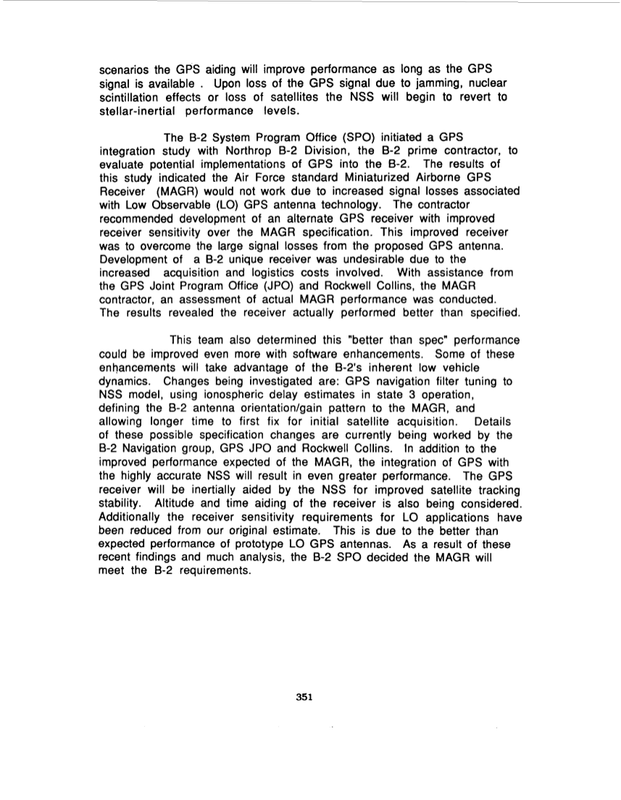

Zu, astro-inercijalni sistem je inercijalni sistem sa povremenom korekcijom prema položaju zvezda. Nije potrebna intervencija posade, već je sve automatizovano. To je vrlo kompleksna i skupa oprema i nije nikada korišćena na komercijalnim letelicama, samo na vojnim. Evo primera:
Ključne rečenice su:
The primary navigation mode during cruise is coupled Stellar Inertial.
The GPS aided NSS solution will also provide better accuracy for weapon delivery in conventional scenarios. In nuclear scenarios the GPS aiding will improve performance as long as the GPS signal is available . Upon loss of the GPS signal due to jamming, nuclear scintillation effects or loss of satellites the NSS will begin to revert to stellar-inertial performance levels.
