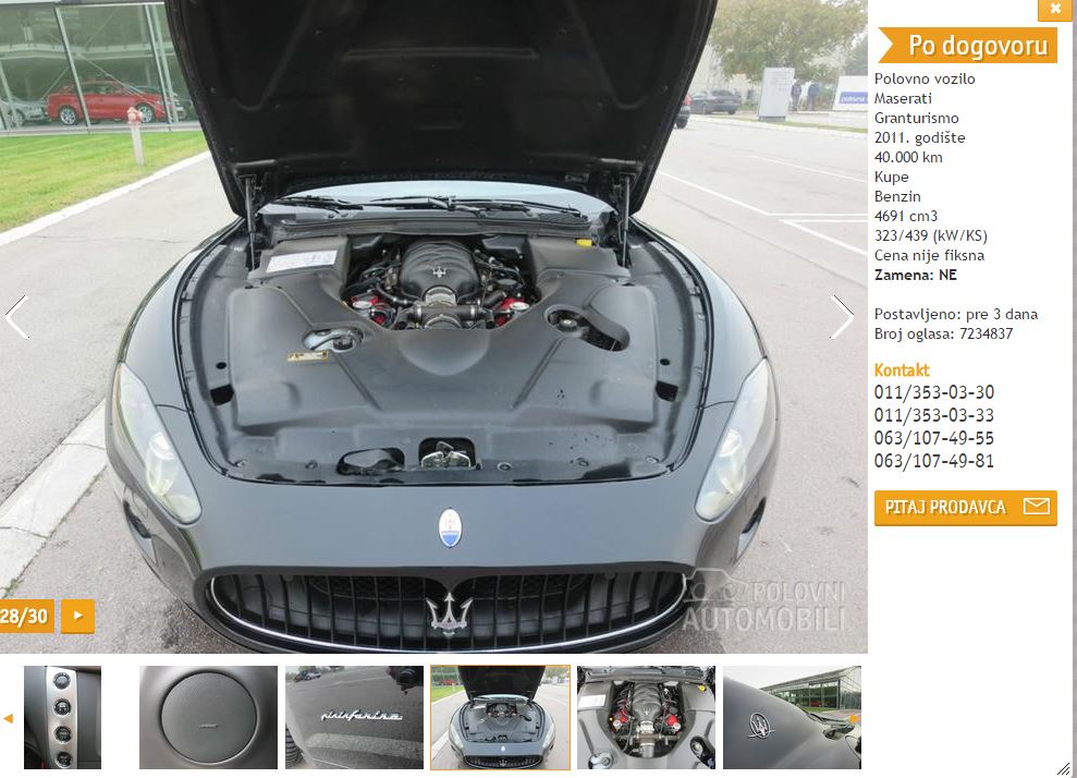

http://www.polovniautomobili.com/putnic ... na-prodaja
Sent from my Tapatalk using Alcatel One Touch Idol
Milos
Postovi: 9276
Garaža: tedeijevi geteijevi
Re: Zanimljivi oglasi
Post od Milos »
Bas lep primerak 308.
Moćan auto.
