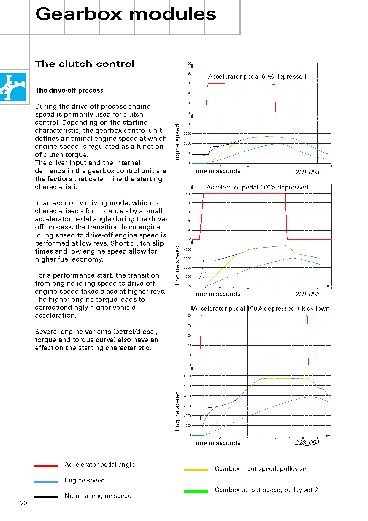

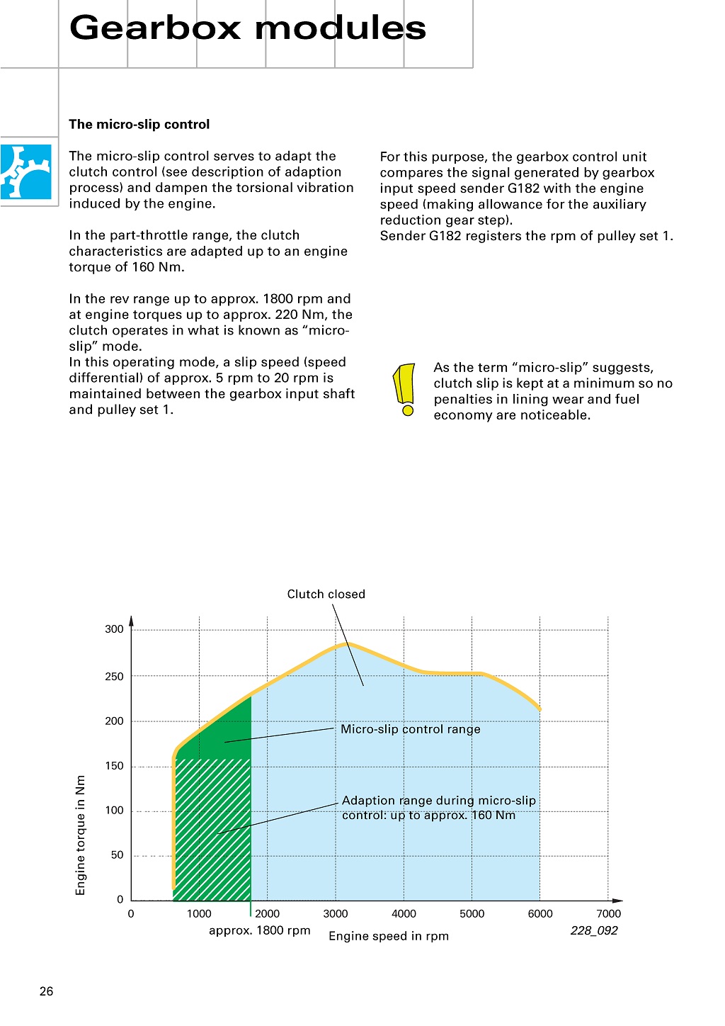

Transmission efficiency is a decisive factor with continuously variable transmissions
(which here relates principally to pulley transmissions). It is significantly
worse than that of geared transmissions.
This is partly due to the chain itself, but
also the variable displacement and contact pressure pump which the design requires;
it is needed to ensure that the taper discs make contact at all power levels.
The efficiency of the engine and the transmission offset each other. You could say
“what the right hand gives the left hand takes away”.
