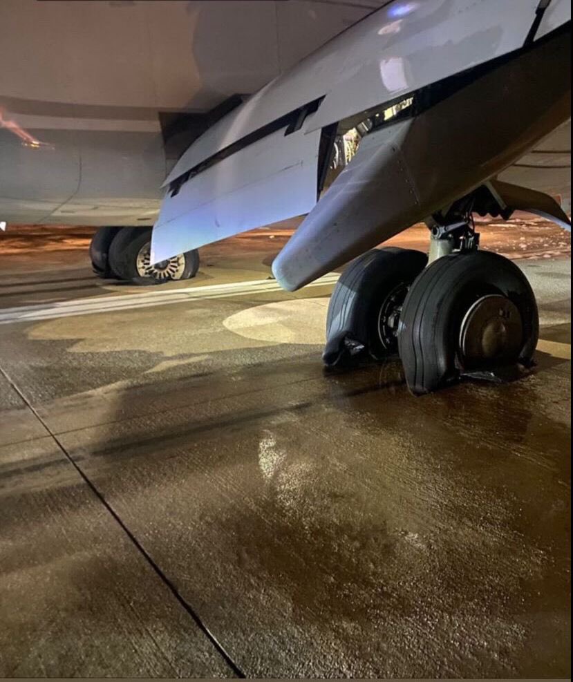

Turkish dobro pocepao gume.
Turkish Airlines THY Boeing 737-800 (TC-JVN, built 2016) suffered multiple tire bursts during landing runway 04 at Antakya-Hatay Airport (LTDA), Turkey. An emergency evacuation was carried out. There were 104 pax+6 crew on board flight #TK2256 from Istanbul.
Re: Vazduhoplovi
Verujem da nije radio anti skid, pa onda ne moze da radi ni auto brake.
Vreme je, cudno za Hataj, bilo bez vetra. Pista dovoljno dugacka. Suva.
Po sletanju je legao na kocnice. Manuelno kocenje daje veci pritisak nego MAX kocenje.
U THY instruktori ne dozvoljavaju da se koci bez auto brake tako da mnogi f/o nikada ne ukoce avion, a i sami cpt retko kada. Tako se prave mentoli.
