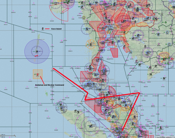

ftj napisao:Nije mi jasno da je sistem toliko ranjiv. Po ovome ispada da je dovoljno da ti kao pilot aviona kada znaš da ćeš upasti u zonu kad si nevidljiv za radar, isključiš transponder(zašto je uopšte moguće isključiti transponder nije mi jasno), skreneš gde god hoćeš i letiš komercijalnim rutama, i bukvalno možeš satima da letiš a da niko ne provali da nešto nije u redu.
Ja sam se takođe pitao da li je moguće da vojne kontrole leta tako opušteno posmatraju saobraćaj u civilnim koridorima. Mislio sam da im se letovi i rute unapred najavljuju i da znaju šta treba a šta ne treba da bude tamo...
U svakom slučaju pronašao sam na netu vrlo interesantan blog nekog Malezijca koji je radio za Royal Malaysian Air Force pa je opisao kako otprilike funkcioniše malezijska vojna kontrola leta i zbog čega niko nije podigao uzbunu kada je MH370 promenio kurs. Citiram nekoliko najinteresantnijih delova, ostatak svakako vredi pročitati.
There are several air defence centres around Malaysia covering both the Peninsula, Sabah, Sarawak and FAR beyond. The RMAF Air Defence radars saw the MH370 tracked West Southwest to waypoint VAMPI (68 nautical miles East Northeast of Lhokseumawe, Indonesia), then Northeast to waypoint GIVAL (69 nautical miles South Southwest of Phuket International Airport) before tracking Northwest towards waypoint IGREX (100 nautical miles East Southeast of Car Nicobar airport on India’s Nicobar Islands), the last known position according to the primary radar. Where MH370 went to after this point is unknown at this point, but I believe the Indian Air Force’s Andaman and Nicobar Command’s primary radar there would have caught the MH370 in its scope.
So, if the MH370 was seen to deviate from its intended course, why didn’t the RMAF scramble its fighters to intercept the airliner?
Every bogey (unknown aircraft) would be tagged by an Air Defence Officer and this data will be processed to ascertain whether it was a threat to air defence or otherwise. In the case of the MH370, it was not regarded as hostile. Should our fighters have been scrambled? If you remember, the MH370 was no longer in our airspace. When the MH370 tracked West Southwest from IGARI to VAMPI, she did not cross Malaysian airspace. She flew over Thai airspace and into Indonesian airspace, then tracked up to GIVAL near Phuket and subsequently to IGREX near India’s Nicobar Islands (see below).
When she tracked from IGARI to IGREX she entered an area with two Royal Thai Air Force fighter bases namely the RTAF 7th Wing in Surat Thani and the 56th Wing in Hat Yai. They, too, were not scrambled. Nor were the fighters of the Indonesian Air Force (TNI-AU) scrambled from Lhokseumawe or Banda Aceh in Aceh, or Suwondo in Medan. If you think the Indonesians are as incapable as the RMAF, they forced a US military transport down without scrambling their fighters at their base in Banda Aceh on 20th May 2013 for entering Indonesian airspace without proper clearance.
Nešto slično je rekao i Tajland, videli su ga ali ga nisu tretirali kao pretnju. Šta je potrebno da bi bila pretnja, to nisu rekli.
Ovo je zvanična ruta između waypointa na kojoj Malezijci kažu da su ga videli:
Pogledajte gde se nalazi indijska komanda na Andamanskim ostrvima pa zaključite kakve su šanse da ga nisu videli. Ili kakve su šanse da ga Indonezija nije videla. Tajland je barem rekao da ga je video ali izgleda da nisu imali bilo kakav razlog da sumnjaju u nenajavljenu letelicu bez transpondera koja im upada u vazdušni prostor. Takođe je potpuno nejasno kako je avion od waypointa IGREX mogao da ode na jug Indijskog okeana a da ga Indija i Indonezija ne primete. Morao bi da napravi neki ultra lukav manevar iza ili preko Andamanskih ostrva pa onda okolo na jug. I da pri tome dobro zna gde su indijski radari i koliki im je domet.
